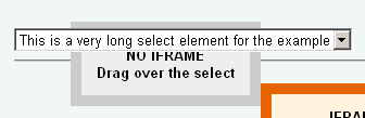

In this example, we'll add an iframe shim to a Drag and Drop element to account for a known display bug in Internet Explorer 6 regarding the z-indexing of select elements.  For you folks out there not using IE6, here's a screen shot of the bug in action.
In this case, there is no way other than browser sniffing or conditional comments to address IE's rendering bug. We'll choose sniffing over using proprietary extensions.
