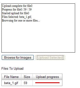

When you have the example running on your own server, it should look like the screenshot below:
