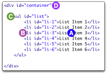

To do this, we'll rely on DOM event bubbling — the process by which an event progresses from its direct target up through the target's node ancestry until it reaches the window object.  The graphic below may help to illustrate the flow: In this case, we'll count on the fact that a click or a mouseover on (A) the text node within an <li>  progresses to the <li> element itself (B), then to the <ul> element (C), and then to the list's parent <div> (D) and so on up the document:
Because events flow this way, we can count on events happening to our <li>s bubbling up to our <div> whose ID attribute is "container."
We'll start with some structural markup — a <div> containing a <ul> with 6 <li> children. Note that our list items have ID attributes — this gives us a way to uniquely identify them when we process clicks and mouseovers at the container level.
