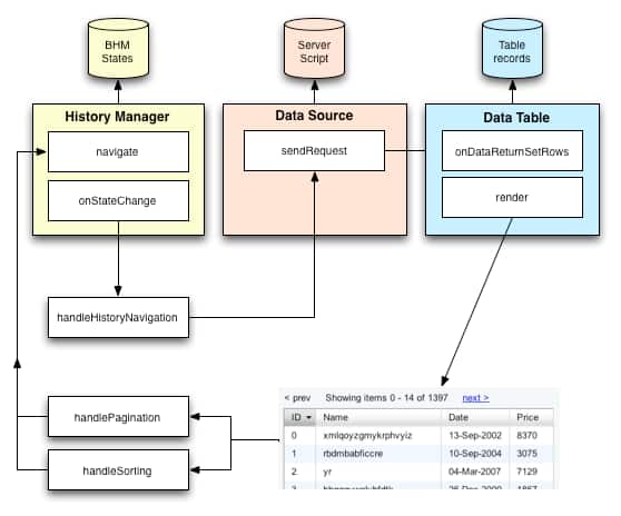

To inject the Browser History Manager into DataTable pagination and sorting, we need to create a few custom functions and insert them into the normal flow of operations. Here's a diagram of how the code below will operate (note the methods in floating boxes are our custom functions):

To facilitate the Browser History Manager remembering pagination and sorting states, we'll need to use custom pagination and sorting handlers.  Each will generate a new state and simply call the BHM's navigate method.  The onStateChange handler will take over from there.
Finally, we create the DataTable instance and the supporting class instances in the History Manager's onReady handler.  This guarantees that whether users arrive at the page fresh, from a bookmark, or from navigating via the browser's back/forward buttons, the DataTable will display the appropriate state.
